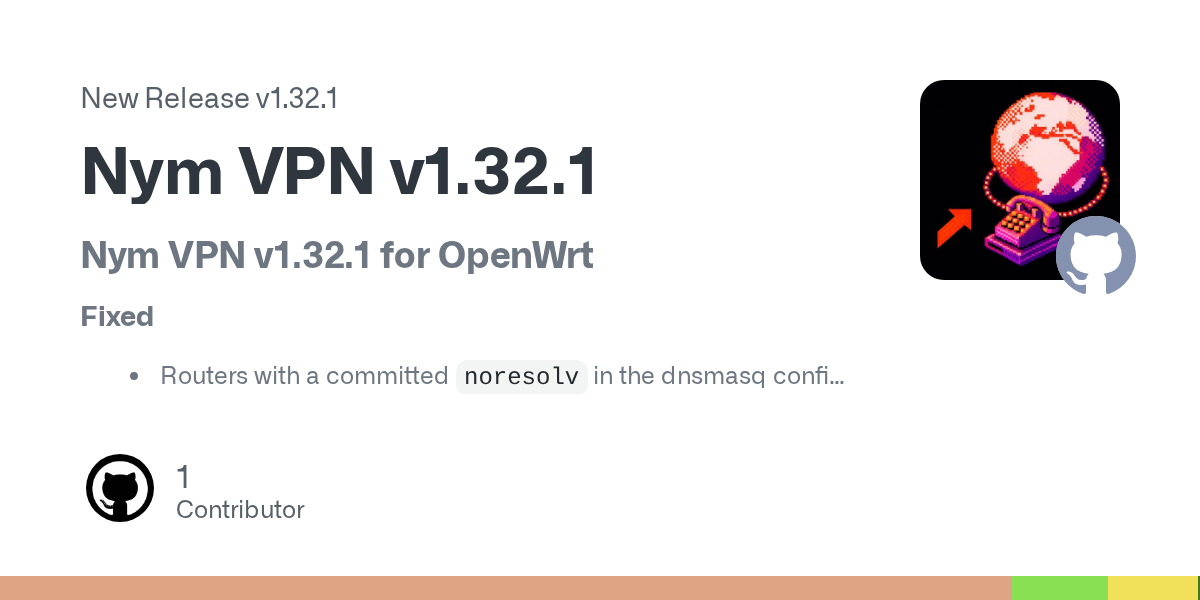

Could you post the output of uci get dhcp.@dnsmasq[0].noresolv?
Yes, it shows:
root@OpenWrt:~# uci get dhcp.@dnsmasq[0].noresolv
1
v1.32.1
  • Fixed: connect failed on routers with noresolv set (AdGuard Home, https-dns-proxy, stubby) - the daemon now leaves dnsmasq alone and your own DNS upstreams just ride the tunnel.
  • Fixed: ad-blocking silently stayed off after a restart or reboot with the kill-switch on.
  • Fixed: a crashed daemon could strand the router behind its own kill switch - stop now always tears the firewall down, and the service respawns instead of giving up.
  • Security: WireGuard (gotatun) bumped to 0.8.1 - fixes a remotely triggerable crash, cross-peer allowed-IPs spoofing, and nonce-limit enforcement.
