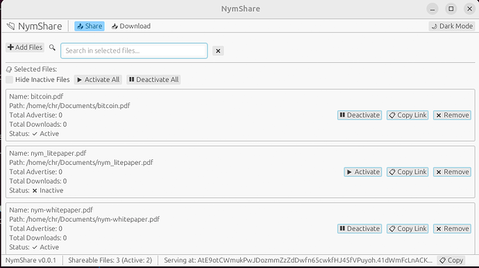

Here I have the bitcoin whitepaper available for download
FCi8ZxMhuogiCVVpZm6ZRNDRnGW9vuh5u2zi5VL6Rygh.3txa2AfEKzGQMhYc4GWBytza6S7qUa4VwgXUJhLZUcN9@8jvZbg811gJLCPwdpjJSwEq6Gktca2MpK6AaMB8WbFiX::bitcoin.pdf
Here I have the nym whitepaper available for download
FCi8ZxMhuogiCVVpZm6ZRNDRnGW9vuh5u2zi5VL6Rygh.3txa2AfEKzGQMhYc4GWBytza6S7qUa4VwgXUJhLZUcN9@8jvZbg811gJLCPwdpjJSwEq6Gktca2MpK6AaMB8WbFiX::nym-whitepaper.pdf

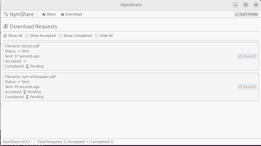

Some images

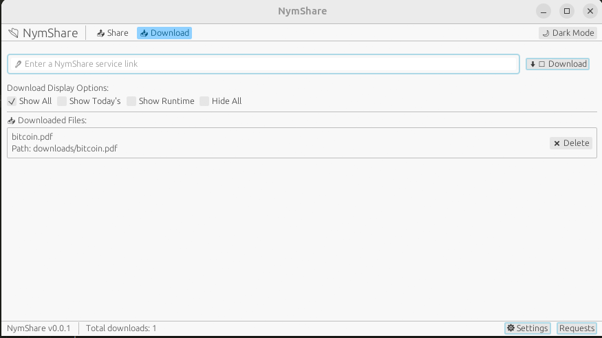

To test, go to the Share tab, add files, activate them, and copy the link to share with others or use yourself. Then, paste the link in the Download tab and click Download to retrieve the files via the mixnet.

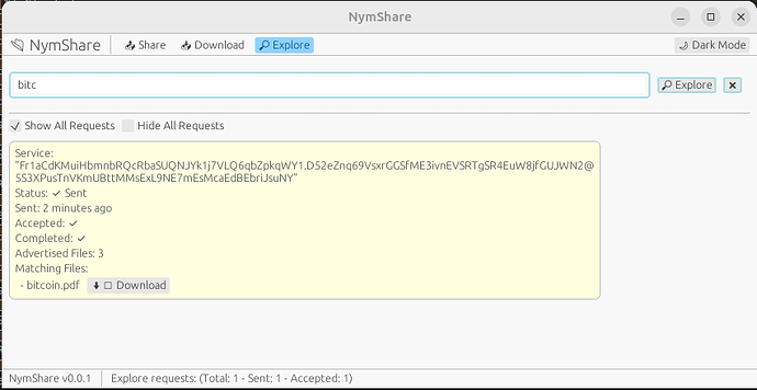

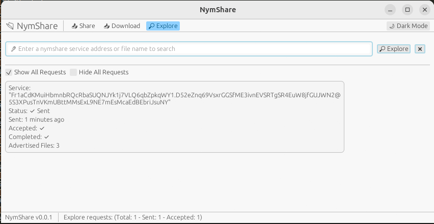

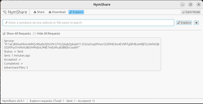

I’m adding advertise mode in next release, servers in advertisement mode now provide a list of available files via explore requests, allowing clients to select which files to download. This simplifies content discovery, as users no longer need specific file links — knowing the server’s address is sufficient.
To avoid displaying every advertised file for each explore request, only the count of files is shown. With this search feature, you can search for a file name and check if it appears in one or more of the advertised files.
