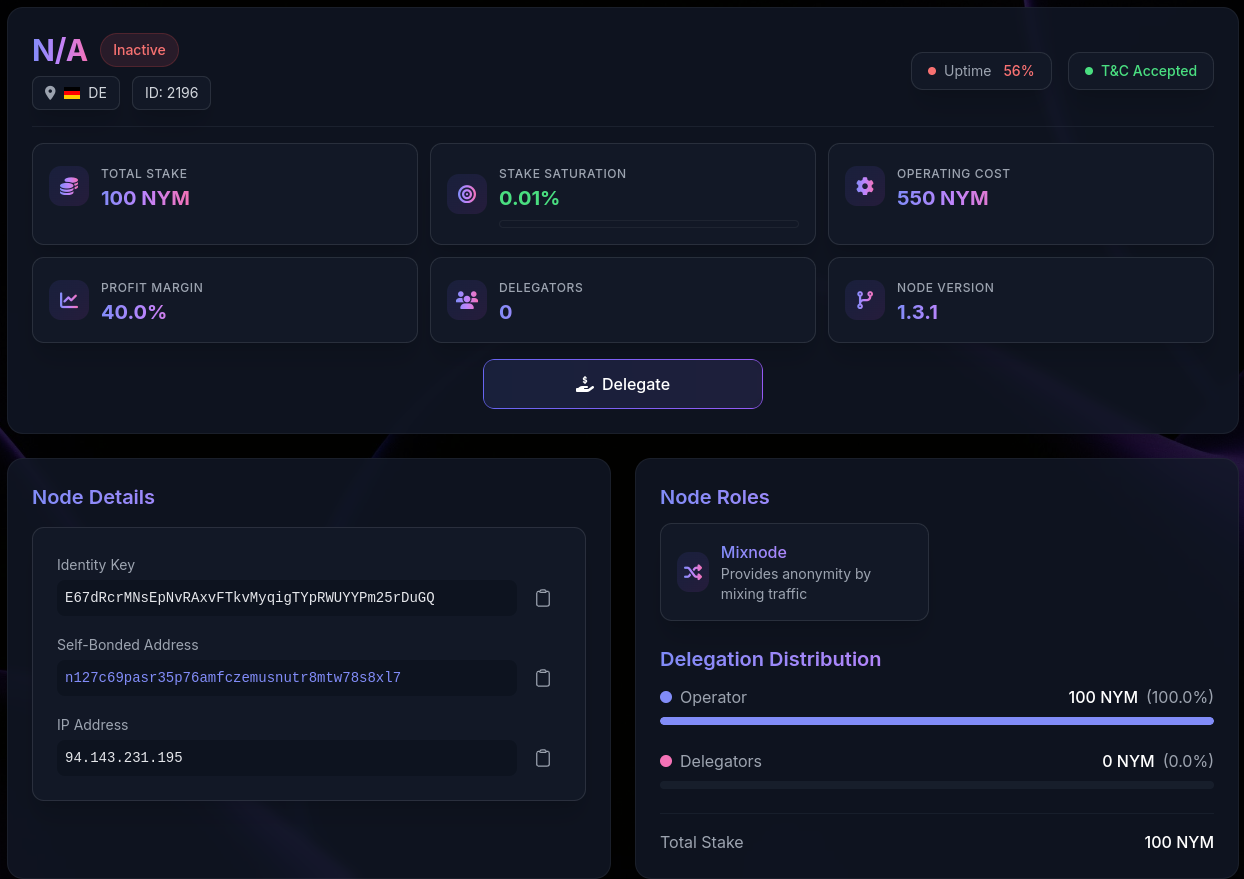

Thank you very much for that tip! I can now see my node:
But I still cannot find it in harbourmaster?? I tried via different search criteria. Would you be sone kind to check this yourself and let me know if I am doing something wrong? Thanks!!

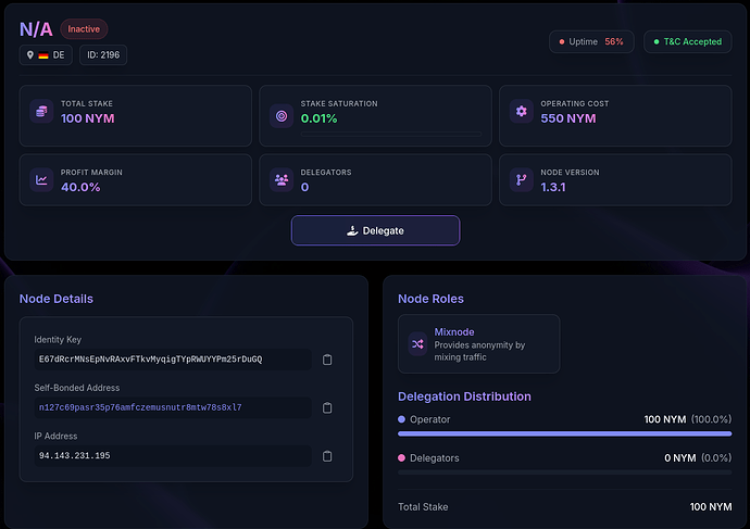

I have compared my node:
With somebody elses node:
Compared to this other node my node is marked as “inactive” at the very top and I cannot use the ID: 2196 of my node to get information about my node in the harbourmaster, while the ID: 708 of the other node is available in the harbourmaster: Nym Harbour Master
What does this “inactive” mean and how can I make my node “active” then?

Hello. Can you please tell me if you managed to solve the problem with the node not active?
I am also running my node and I am facing the same situation - my node is marked as inactive. Also, like you, I don’t see my node in Harbourmaster but I do see it in Specter
My Node in Spectre
I see that your node is still inactive. I am in the same situation. I think I have done all the settings correctly, but my node is still not active.
Any tips or ideas on how to solve this?
My Swagger node info
In the operators matrix chat @serinko replied: “Active is whether it was chosen to the active set”. My understanding is that from time to time the “active set” is randomly chosen among the available nodes.
