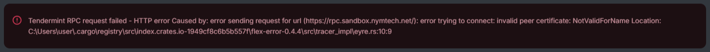

Second, when I switch my wallet to testnet, I get an errormessage:
So Question 2: Is my wallet broken? Or is the testnet broken?

Your wallet is not broken. The error was caused by an outdated RPC URL. Please use:
validator-sandbox-1.nymtech.net
