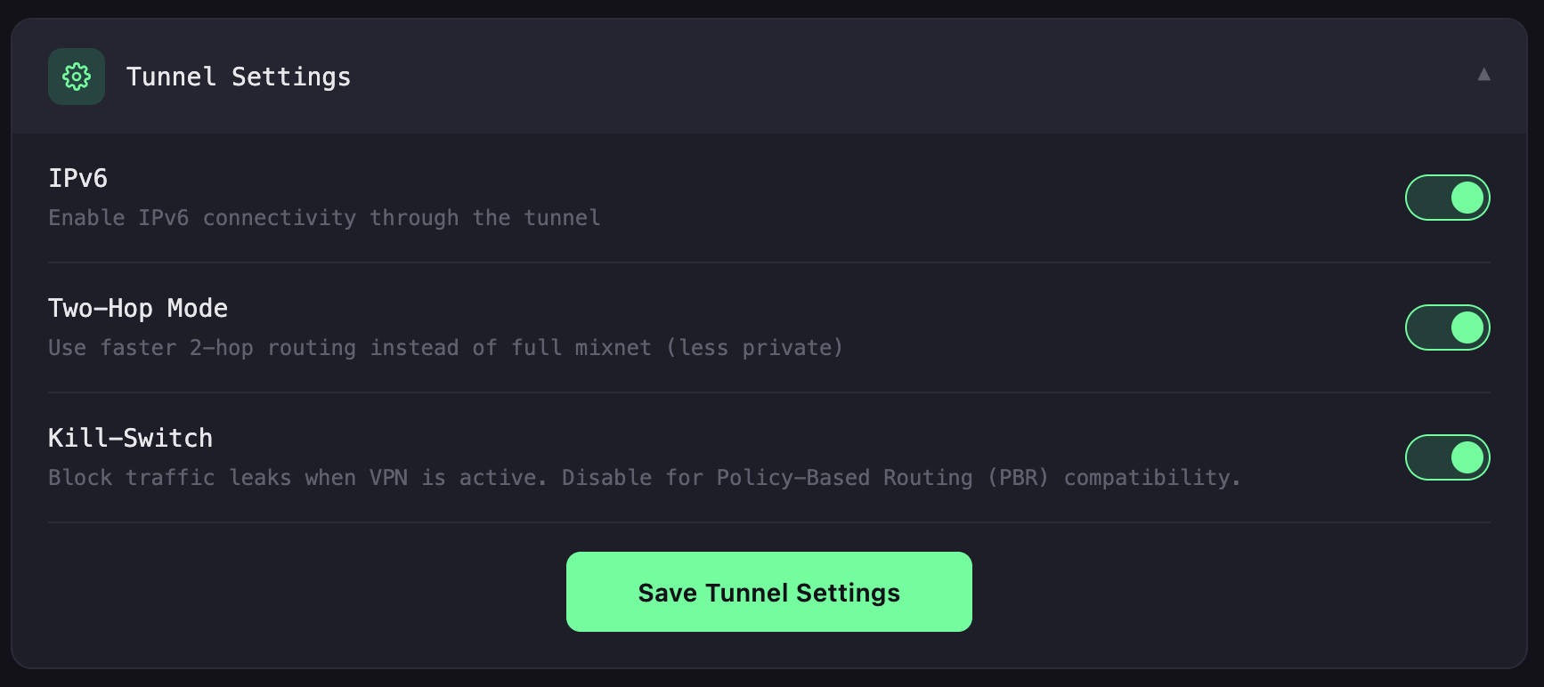

Please add an option to disable routing on the vpn interface so that I could use pbr to route certain domains to the nymvpn mixnet

  • Instead of relying on Wireguard kernel modules, I’m changing the backend to use Mullvad’s user space implementation, GotaTun.

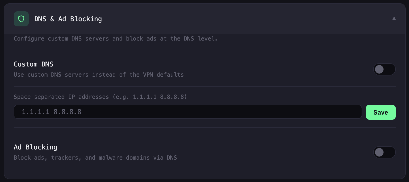

  • Pure rust user space wireguard via Mullvad’s Gotatun
  • Ad blocking
