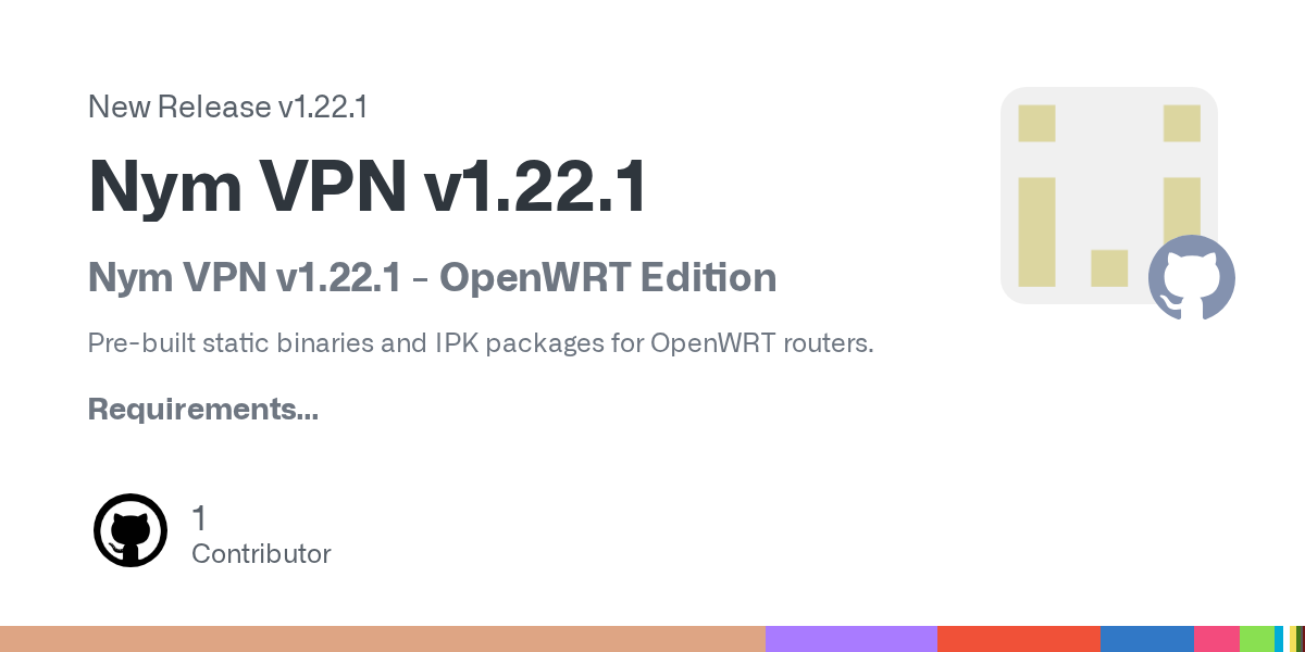

Fixes are ready!
Changes:
  • Added firewall rules to ensure DHCP works
  • Use /etc instead of /var for config data
Install the latest .ipk for your arch here:

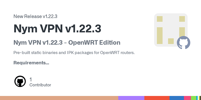

Amnezia-WireGuard Support Now Available for OpenWrt
Added support for Amnezia-WireGuard in the latest release. This provides WireGuard with traffic obfuscation, making VPN connections harder to detect and block.
What’s new
  • Automatic detection of Amnezia-WireGuard kernel module
  • Falls back to standard WireGuard on older systems
  • IPK package auto-installs the appropriate kernel module
Requirements
  • OpenWrt 23.05.4 or newer (oldest version with Amnezia packages available)
  • Packages are pulled from the awg-openwrt community repo during installation
Download
https://github.com/dial0ut/nym-vpn-client/releases/tag/v1.22.3
Older OpenWrt versions continue to work with standard WireGuard.
