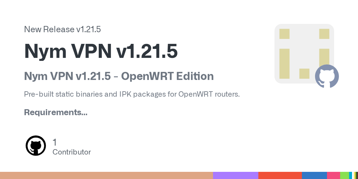

Happy New Year everyone!
Try the latest release, I rewrote the killswitch to be compatible with OpenWRT. I think this was the root cause of quite a few issues. The killswitch was previously optimized for end devices like laptops and phones, not routers.

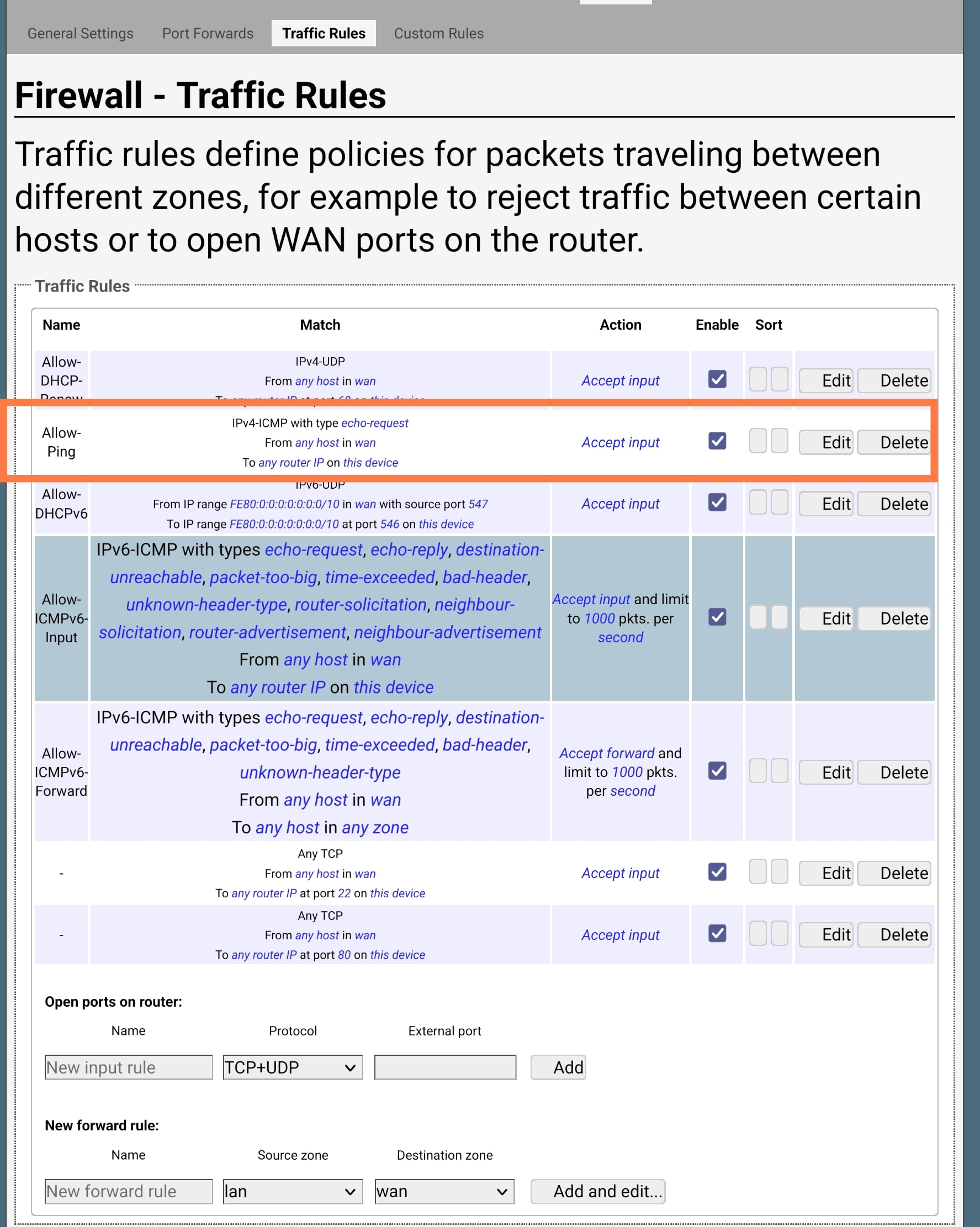

Thanks. Installed but for me its the same issue producing.
Questions
  1. How are you accessing the router when it locks up?
    • Are you on the local LAN (192.168.2.x) via WiFi/ethernet?
    • Or remotely via GL.iNet’s WireGuard server (I see wgserver running on 10.1.0.1)?
  2. When it becomes unresponsive, can you still ping the router?
    From a LAN device, try:
    ping 192.168.2.1
    Does it respond, or is it completely dead?

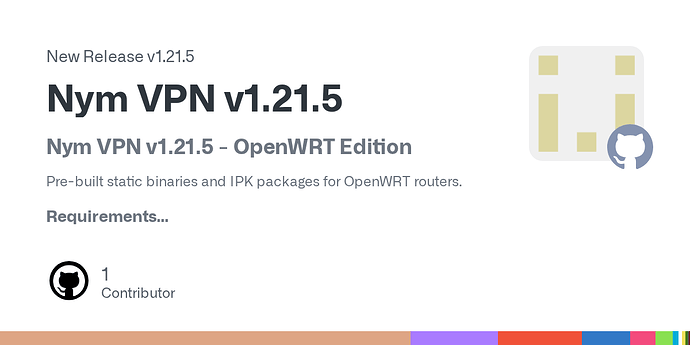

The release build is running now, should be done in 15-20 minutes. Try out the latest release once it’s finished, v1.21.6.
Looks good for now. It connects and I can connect to other LAN Clients.
