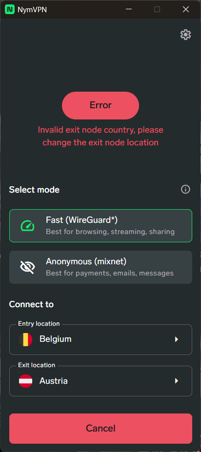

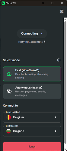

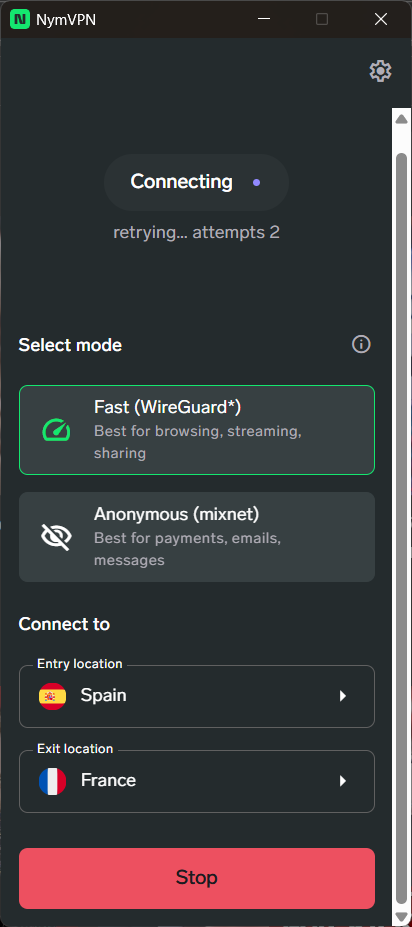

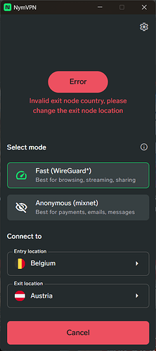

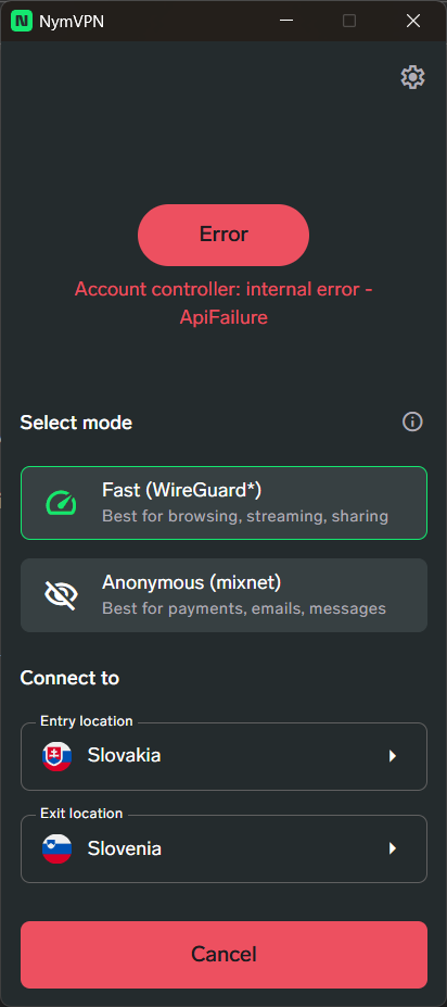

This happened to me too. Apparently, this happens if you update via the app pop-up. I managed to align the versions by uninstalling and downloading again from the website. This allowed the VPN to work again, but only briefly; the next day it started giving me various errors.
Indeed, a manual app re-install should do the trick. The issue lies with the auto-updater.
@an_Olek would you mind sharing the other issues you are experiencing? Thanks!
