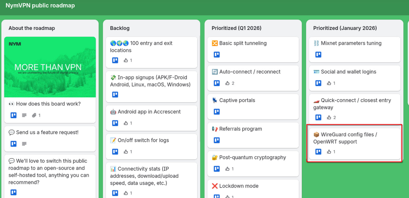

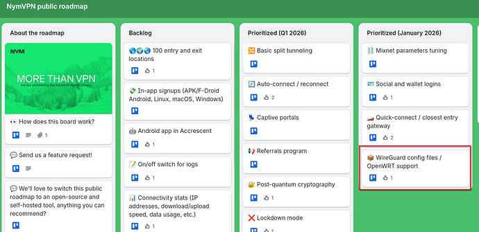

Hey NYM team, thanks for what you do it’s awesome! Please help us hooking up our routers, I can’t wait =]
