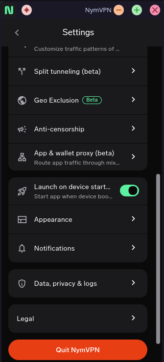

Hi I have selected the option Launch on Device Startup. But it doesn’t start and when I start it manually I need to sudo into the daemon every time
Is there a way to fix that?

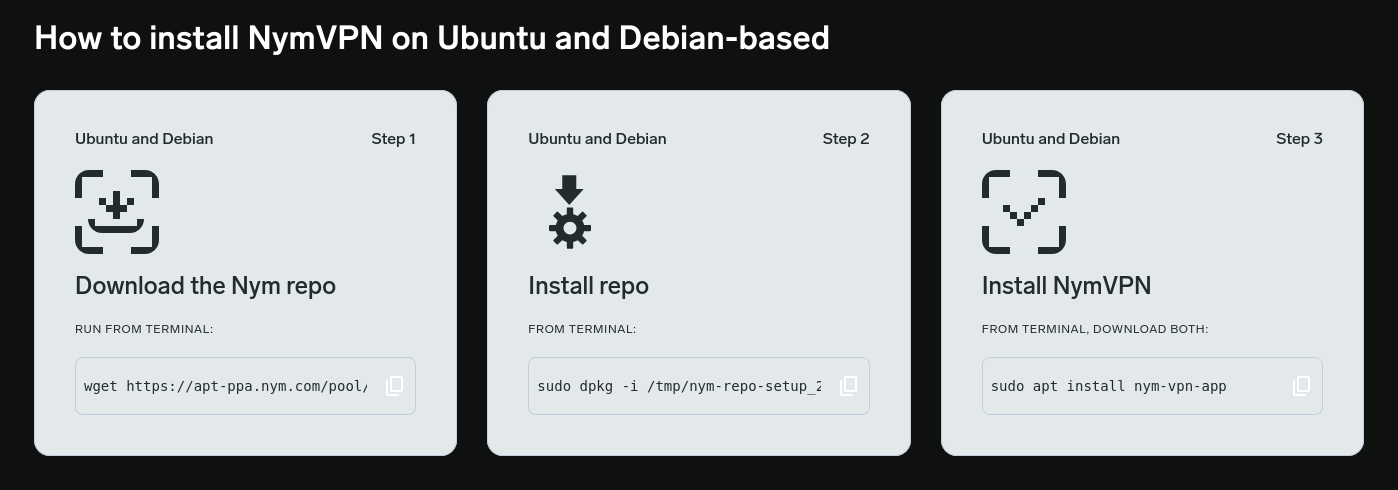

I followed these instructions from nym.com
Download NymVPN for Linux | Nym
If you followed that it should be installed correctly.

Also it not starting means that the vpn window doesn’t open on reboot, correct? Not that it doesn’t connect automatically?
If nym-vpnd.service would be enabled and active, you could try creating and enabling a systemd user service executing the nym vpn gui app binary instead of relying on the option in the app.
You could also create and enable another systemd service that runs nym-vpnc connect. This automatically connects to the VPN if you’re logged in.
