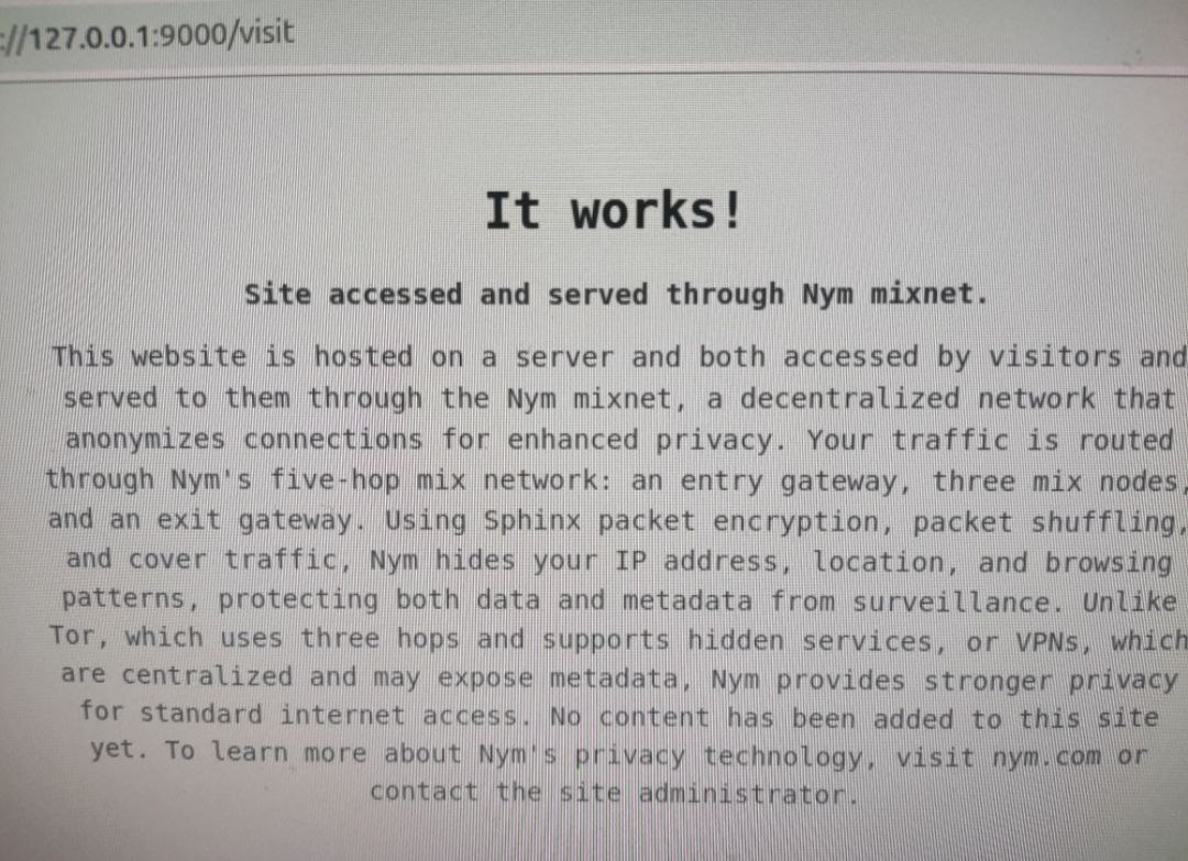

Have you checked out NymShare? Instead of downloading all sorts of files, one would use the same scheme as a standalone browser, to access nym://nymaddress. I guess a custom version of NymShare could be done, which acts as a text or MarkUp reader. Simply said, keep it simple for developers and users.
I use the Nymshare approach to serve a page, using a local mini browser to fetch it anonymously, I have no other photos and this one is from telegram channel that I had post it.
Pretty awesome! This is exactly what I mean and should be the easiest and best approach.

@XRoot I am currently working with two friends on a Rust MarkDown Server and Client for the Nym Mixnet, inspired by your photo. :slightly_smiling_face: Tests have shown with some previous html tags that it works with the Nym Mixnet. But we changed to MarkDown language, to have a clean page viewing system, without graphics or sound, like Gopher or Gemini. We will call it NymView.
Interested, on my approach the server-side implementation was actually the easiest part roughly 200 lines of code in total, I used Nymlib Rust workspace designed to make it easier to build applications on top of the Nym mixnet
This worked in two main stages.
First, the website loader scans the project folder for all .html files, reads their contents, and stores them in a HashMap, using the lowercase filename (minus the extension) as the key (for example, index.html becomes “index”).
Second, the Nym mixnet client listens for incoming messages. When a request arrives at the listener client, it checks whether the message specifies an endpoint. If no endpoint is provided, the server returns the contents of index.html by default. If the message includes an endpoint such as, contact.html, about.html the server looks up the corresponding page key and returns that HTML file’s content. Otherwise, it responds with a simple 404 “Page Not Found.”
That’s the entire flow like NymShare, and it already behaves like a lightweight web server just running over the Nym mixnet instead of the traditional internet. From what I can tell, anything that can be built on top of Tor can also be built on top of Nym, what we really need is for more people to explore the possibilities and get interested..

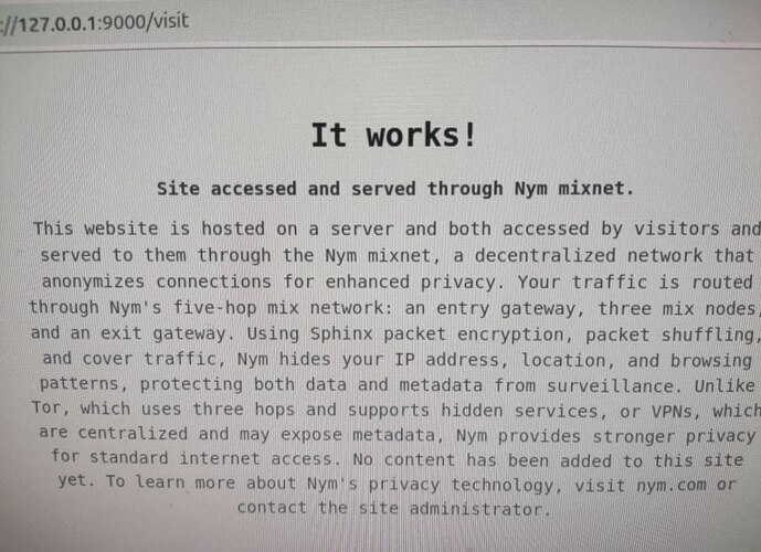

This is currently how NymView Browser looks like.
Awesome, keep us updated. I’ll probably be back soon on computer and I will be able to test, help, etc.
Thank you very much, XRoot. I now have to do the localization into English. Once done I will send you via PM a download link, for testing etc. .png image support is added as well, because I expect people like to have that feature and via the Nym Mixnet page loading is fast. The only thing I will leave out is a bookmark toolbar/browser, to keep
the UI clean. I for myself will store anonymous nym:// URLs anyways in an encrypted seced file, for copy / pasting.
